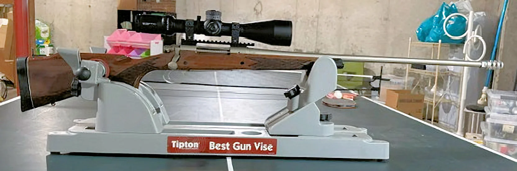

Personally I like shooting more than doing a lot of tinkering. I have two AR Platforms, an AR-15 in 5.56 and an AR-10 in 308. They are both Palmetto State Armory upper and lowers, emphasis on the barrels. Both shoot sub moa and the two together did not cost me $1000. I see no reason to spend thousands of dollars on any rifle if a less expensive one will do the same thing. The most I have ever spent on any rifle is $900. Additions, scope bases, rings and the scope are not in that price and are extra. The $900 rifle was a vintage 1966 Remington 700 BDL in 338 Win Mag. I bought it in an auction not knowing a lot about it other than it was rated in like new condition. Once I got it home and went to clean it up when I bore scoped it, the barrel was virgin, never been fired. Took pictures and showed them to some very good gunsmiths that I know and they agreed, never been fired.
It was in a cheap, and I do mean cheap plastic stock, non adjustable trigger and shot 0.6 MOA using cheap 210 gr ammo. At that point I decided to take it and turn it into something special. New original Remington BDL long action stock. I put a new Limbsaver recoil pad on it and had it pillar bedded the barrel floated and installed a competition muzzle brake. I took the old trigger off and put on a new Triggertech Diamond two stage trigger and set it to 2 pounds. Optics are a Talley 20 MOA rail, Vortex Pro Rings and a Vortex Strike Eagle 5 - 25 x 56 scope on it. The new muzzle brake opened up the groups slightly, now shooting between 0.6 MOA and 0.9 MOA with all ammo, 180 through 250 gr using Nosler bullets and a variety of powders.
